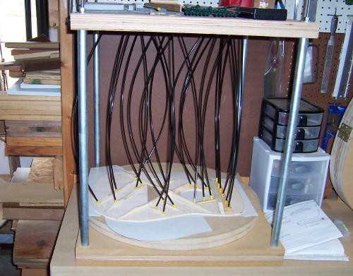

I have standard height workbenches, but I made one about 40" high for the go bar deck to sit on. I'm 6'2" also. It works well for me. Actually, I assemble all over the place. Including my regular bench, and my table saw top.
My go bar deck is made of three layers on the base, 2 mdf and one 3/4" plywood sandwiched between them. The top is 2 layers of 3/4 plywood. I used 3/8" all thread and 3/4" conduit. Regular flat washers and regular hex nuts countersunk. Its very sturdy (overkill) but I like it and it works great. The top is about 24" from the base and I use 24" fiberglass go bars. They don't have to bend much to exert full pressure. I use 3/16 rods. I have some 1/4" rods, too, but they are tooooo strong for a spruce top, 3/16" is perfect. I also left my all thread about 10" long above the top of the deck in case I need more room. Fiberglass rods can be bought very cheap at "intothewind.com". If you get more than 11, they are $1.25 each and are 48" long. I bought 20 and cut them in half. That works great for clamping braces. When I clamped the top and back onto the sides, I left the guitar in the mold, so I made about 30 shorter rods for that.
BTW, I also sunk my conduit about 1/2" into top and bottom.

Nelson, I'm using 3/16" fiberglass rods. Nearly unbreakable, very consistent pressure (about 8 pounds per rod) and cheap. Order from "intothewind.com", they are a kite making outfit. Order 12 or more and the rods are $1.25 each and they are 48" long. Cut them in half and that's dirt cheap. Also get enough end caps for all the rods you're going to make.
fiberglass go bars here

As for the go-bar deck, the details aren't important. The basic design is simply a piece of wood on the top, a piece of wood on the bottom, and any hardware that will keep them roughly the same distance apart. It doesn't much matter whether you use plywood, MDF, or whatever. It doesn't much matter whether you are using aluminum washers, stainless steel, or what. You can use steel conduit or PVC. Wing nuts or hex nuts. It all works the same.

When I built my go-bar deck several years ago, i built everything too light. My first 20' arch top turned out to be about 13' when I pulled it out of the deck. The dish AND the top & bottom MDF plates on the deck were all noticeably distorted. After that experience, I got really silly & my "opus two" dishes weigh about 20 pounds each. (Stressed skin construction, 3 layers of 3/4" MDF) Solid as a rock, but don't drop one on your toes!!!
Somewhere in the middle, I'm sure there is an ideal.
To fix the deck, I screwed & glued stiffener strips to the upper & lower surface.

Charlie, what are you using to make your dish? If your dish is solid (i.e., thick enough not to bend under the pressure of the go-bars), I think all that material on the bottom slab of the deck is overkill.
My dish is two slabs of 3/4" MDF, and it doesn't bend at all. My go-bar deck has 1 sheet of 3/4" baltic birch plywood on the bottom, and I have no problems. (The top slab is also 1 piece of 3/4" baltic birch ply.)
The slimmed-down version of the go-bar deck is nice because it's easy store away. Disassembled, it is not very heavy and doesn't take up much room on a top shelf in my shop.
I'm not trying to talk you outof the thicker bottom slab; it certainly won't hurt anything. But IMHO, it's unnecessary.
